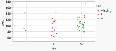

If a user generates a x/y scatter plot and uses a column with missing values as color or overlay, all the points with missing values will DISAPPEAR from the scatter plot.
The "easy" solution:
enable Include Missing Categories from the Shift + red triangle menu - or via the preferences.
Then the points will show up with a separate category:
For nominal values on an axis, it's the same, the values will show up as a separate category.
Very convenient to Explorer Missing values.

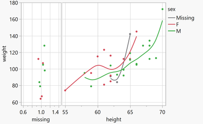

Unfortunately, for continuous values, there is no option to show the missing values separate from the other points.
A workaround: the user can generate a transform column for is missing(:col) and show the points in a separate subplot: Missing entries - modelling type: continuous

Please add an Option Include Missing values to Graph Builder (via Shift + red triangle menu - and maybe via preference) which acts like  Include Missing Categories , but for continuous values - and generates a plot similar to this one:
Why is this idea important?
In combination with column switcher this will add a new, incredibly useful way to explore missing values :)
Just imagine how useful it will be to display missing values in a Graph - separate from the actual values.
