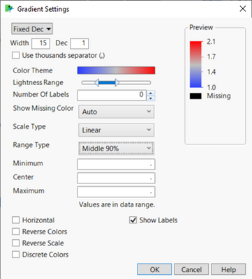

What is the improvement you would like to see?
Possibility to set the default range of a color gradient to Middle 90%.
Alternative options: 1% - 99%?
Why is this idea important?
The middle 90% option is amazingly useful - outliers don't destroy the color settings. Especially for exploratory data  analysis of a "dirty" dataset - e.g. by using the Column Switcher!
But at the moment, the user has to enable the setting manually - and concerning Column Switcher it's disabled after every single switch. Argh!
The possibility to set the default range of a color gradient to Middle 99% would solve the issue

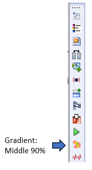

Here is a script which switches forth and back between "middle 90%" and "Default" simultaneously for all Gradients in the current report.
I will add it to Graph Builder Toolbar  ...
