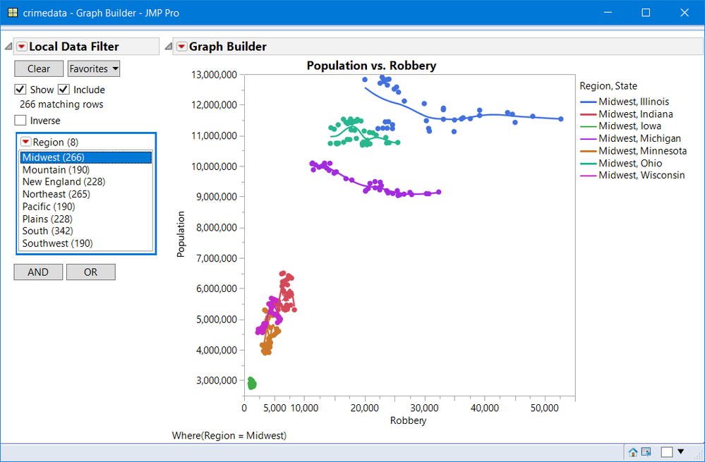

Currently,  there are methods that might meet your needs today:
  • Add a column switcher to your report that switches out the Overlay Variables,
  • Create a new Column, or transform a column to be a concatenation, and
  • for an additional level of control especially for nested overlay variables add a Local Data Filter
Row Switcher example
Transformed column example
Script for the transformed column example:
Graph Builder(
	Size( 491, 454 ),
	Show Control Panel( 0 ),
	Variables(
		X( :Robbery ),
		Y( :Population ),
		Overlay(
			Transform Column(
				"Region, State",
				Character,
				Nominal,
				Formula( :Region || ", " || :State )
	Elements( Points( X, Y, Legend( 1 ) ), Smoother( X, Y, Legend( 2 ) ) ),
	Local Data Filter(
		Add Filter(
			columns( :Region ),
			Where( :Region == "Midwest" ),
			Display( :Region, Size( 160, 120 ), List Display )

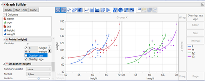

@XanGregg: Is there a reason why it is not possible to use several columns as overlay - and, for each subplot,  to pick the desired column via "variables" (like it is possible for all the other settings).
Surprisingly, it IS possible - triggered by this wish?
Hm, but looking closer, the result is not like expected?!
According to the JSL code and the legend, the two plots use different columns as overlay.
Unfortunately, the "age" overlay looks like a "sex" overlay, just with different colors.
Graph Builder(
	Variables(
		X( :sex ),
		Y( :weight ),
		Y( :height ),
		Overlay( :sex ),
		Overlay( :age )
	Elements( Position( 1, 1 ), Points( X, Y, Overlay( 2 )) ),
	Elements( Position( 1, 2 ), Points( X, Y, Overlay( 1 ) ) )
