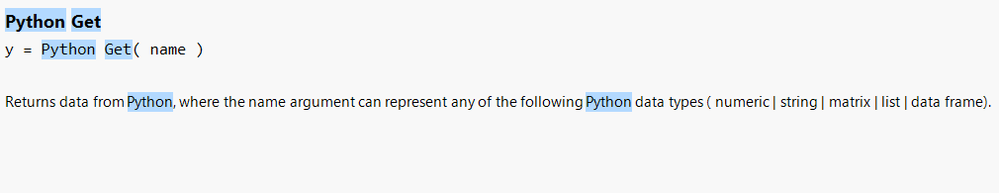

Expand Python Get()
The current documentation of Python Get() states that :
It would be helpful to add the ability to also retrieve dictionaries from Python. Dictionaries are commonly used in Python and will easily translate into Associative Arrays in JMP.
