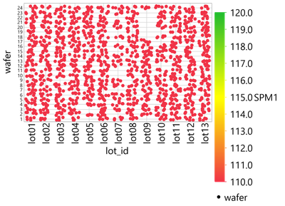

When using Column Switcher in Graph Builder, it is common to switch between many measured variables that have completely different value ranges. A color scale that is meaningful for one column is often useless for another column. Currently, color scale settings appear to be shared across switched columns, which frequently results in misleading visualizations and requires manual adjustment after every switch.

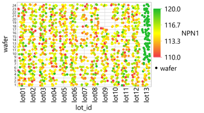

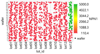

example:
adjust the gradient for NPN1 while keeping meaningful plots for the other parameters
Open( "$SAMPLE_DATA/Semiconductor Capability.jmp" );
:NPN1[1370::1455]= 5000;
Graph Builder(
      Variables( X( :lot_id ), Y( :wafer ), Color( :NPN1 ) ),
      Elements( Points( X, Y, Legend( 7 ) ) ),
      Column Switcher( :NPN1, {:NPN1, :SPM1, :PNP7, :IVP4, :PBA1, :SIT2} ),
      SendToReport(
            Dispatch( {}, "400", ScaleBox,
                  {Legend Model(
                        7,
                        Properties(
                              0,
                              {gradient(
                                    {/*Scale Values( [110 120] ), */Range Type( "Middle 90%" ),
                                    Label Format( "Fixed Dec", 12, 1 )}
                              Item ID( "NPN1", 1 )
