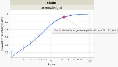

hogi
Level XIII
thanks for updating the status : )
also within  "acknowledged" : among the top 5%
