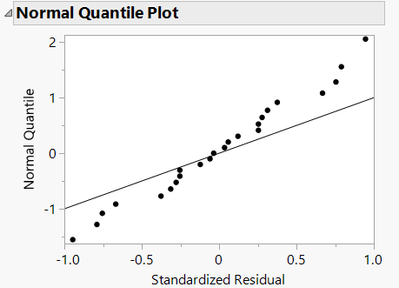

The fit of the solid red line does not seem to match up well with where the residuals fall using Fit Least Squares. The slope of the solid red line is not a good fit. I looked at a few sample data sets and saw issues with the default model scripts in these data sets:
  • 2x3x4 factorial
  • Bounce data
  • Wine data
Below is a plot of the 2x3x4 factorial Residual Normal Quantile Plot. I've been told that the slope of the solid red line is based on the RMSE of 2.02.

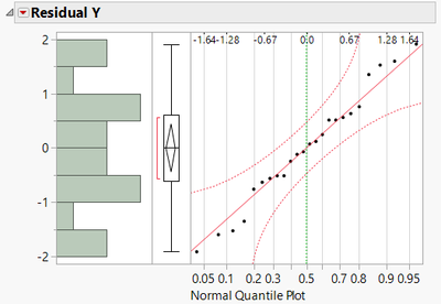

If I save the residuals to a new column and regenerate the Normal Quantile Plot from the Distribution plot, the line is based on the standard deviation of the Residual Y column of 1.03. It looks like a much more sensible fit from a model diagnostics perspective.
Is this something that can be updated in future versions of JMP? Note that when you use Fit Mixed, the results in the Residual Plots there match my desired result from manually saving the residuals to a new column.

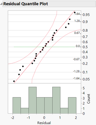

Are there any updates on this thread? For context, I fit the 2x3x4 data example in other platforms. Generalized Regression has a slightly different plot, but with the same issue:
Mixed Model isn't something you would use in this situation since there are only fixed effects in the model, but its output matches the desired result:
