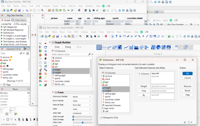

What I wrote in the previous post about hidden columns referred to the columns menu on the left of the data grid.
Besides that:
If a column is hidden (in the data grid) - and maybe even hidden in the column list on the left of the data grid...
it should be hidden in ALL column lists - especially those of the reports:
Is there a hidden setting?
"Don't hide hidden columns in reports?"
how can I deactiate it?
