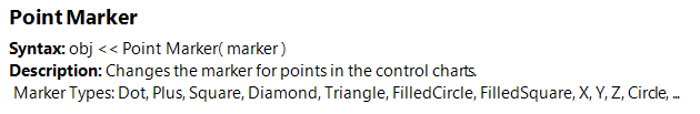

Document the names of the markers. In https://community.jmp.com/t5/Uncharted/Integrate-Interpolate-and-SplineEval/bc-p/657963#M381 it isn't clear that 12 or 16 is a circle or a diamond. As far as I can tell, the pdf doc does not list the names. The scripting index does, incomplete..., here:
An elided list of names.An elided list of names.

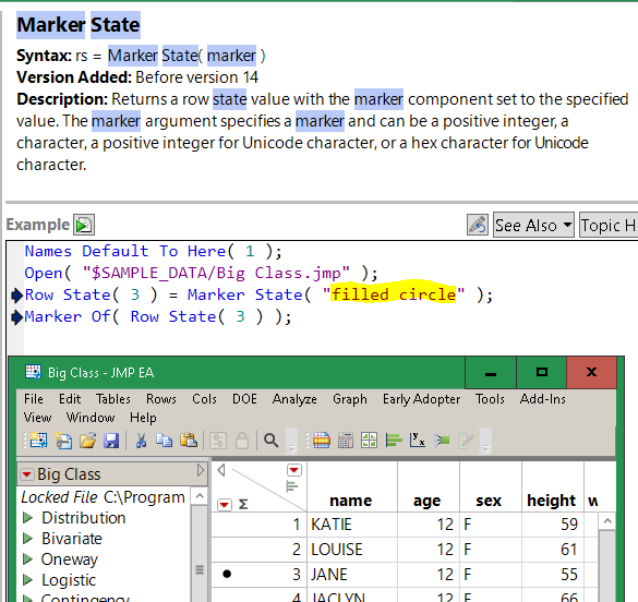

Using them for Marker State is important. The number is pretty meaningless. They already work if only the names can be guessed.
Got that name from the Point Marker list. Note that is for Control Charts and pretty unrelated to row states.Got that name from the Point Marker list. Note that is for Control Charts and pretty unrelated to row states.

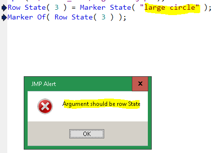

it would be nice if this message was more helpful
List the possible choices as part of the message.List the possible choices as part of the message.

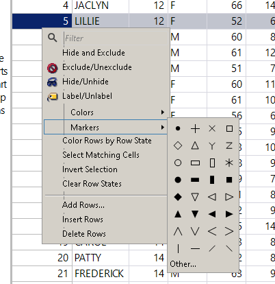

The markers are currently found like this
These are zero-based; the diamond is 16.These are zero-based; the diamond is 16.
and you can see why I might think there would be a large circle. I guess the small circle is "Dot", but the data table shows nothing for a dot. Maybe the scripting index for Marker State can show all the names.
