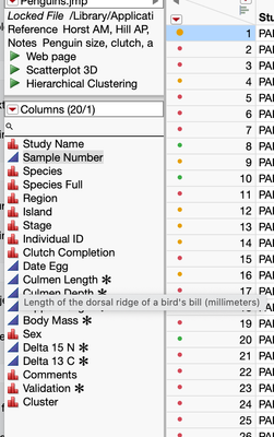

@Michael_MXAK thank you for the input.  If you hover your mouse over the modeling type symbol for the column in the Columns Pane, it will display the note as a hover box.  We will take your idea under consideration, however.

We checked into this further, and currently, we do display notes as tooltips when you hover over the column header in the data table.

Ah, I see what's happening! I tested multiple times but I've always tested on columns I've selected before hovering.
I'll amend my suggestion to a bug report, which is that tooltips don't display (on Windows) on column headers if the column is selected (the column header is blue). I'll send it to [email protected]!
