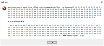

I would like JMP log to be smarter when user by accident, alert is shown OR on purpose prints long text to log (matrices, lists, rarely expressions). Alert is able to add "scissors" and show only start and end of the log message. Log window could show more than alert window but still not excessive amounts UNLESS user specifies that they wish to see everything -> there should also be a way to view the whole log (maybe save it to temp file which user could open?).

Loc(Is Missing(dt[0, "Str"])); // prints' everything to log, but alert has just part of it

Alert window with the scissors
and I get to my log 3 000 972 characters of text.
