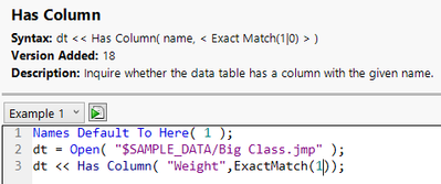

- The idea is related to the option Exact Match (1 |0) of   dt << has column(), which will be introduced with Jmp18:
data table : message column exists(colname)?

check if column exists? is available now as
dt << has column()
it it allows to specify if the name matches exactly.
