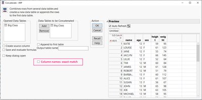

Let's take the Concatenate platform as an example. This platform is very picky with column names.
If Table A has a column :age and table B has a column :A G E,the combined table will contain 2 columns!
In general this is a nice feature: better split the columns, the user can merge them later.
But for user who lived the carefree life of "difference don't matter" - the first collision with Concatenate can be traumatic.
What is the improvement you would like to see?
In Concatenate (and other platforms?) please provide an option "Column Names: Exact match".
If the option is on, Concatenate is as picky as now, if it's off, Concatenate follows the usual rules of JMP/JSL when comparing column names.
