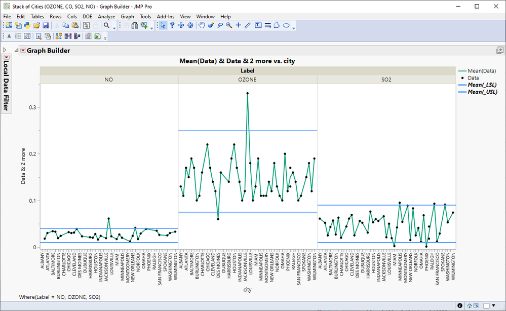

@Clark_Ledbetter if it is only for graphing purposes, currently I would say it is easiest to do with Graph Builder if they have stacked data and specification limits in their own columns (this is what I have done for some of our reporting and tools). It does take some effort as you have to have multiple graph types on top of each other but if they generally use specific types of graphs, they could write a script or create add-in for it.
This is just one example what it can look like, grouping can be done in many different ways depending on the final needs
