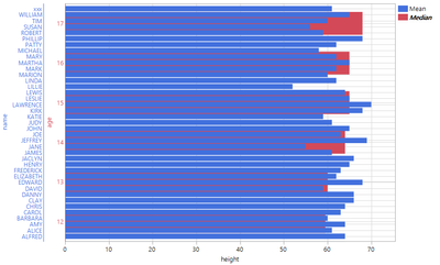

as a workaround:
by  placing the axis label to the left (instead of: below the axis) it get very easy to find out which level belongs to which type of entries:
 Hierarchical X labels

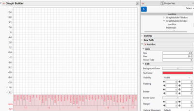

unfortunately, via the Properties menu on the right it's just possible to adjust the color in total, not separately:
