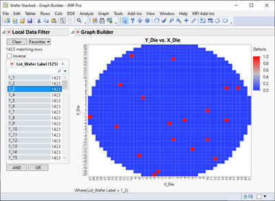

Provide a new option which would prevent from earlier filter being removed before value is selected. Below is an example how it currently behaves:
1. Starting situation with no Lot_Wafer Label's selected
2. Select one value to filter down the data (1_3)

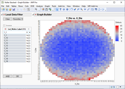

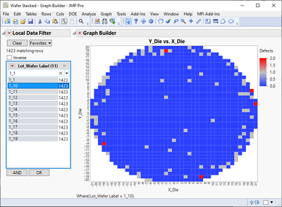

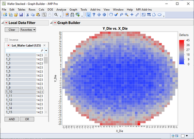

3. Start typing value to Find to find what you are interested in (1_10), when I get to "1_1" earlier filter gets removed and all data will be visible and no filter selected. I think this is dependent on the values which are visible, for example if I were to search for "2_10" it would get unfiltered after typing "2" because the original value isn't in the list of values
4. How I would like it to behave is to keep the earlier selection (1_3) until I select new value(s) to filter by
