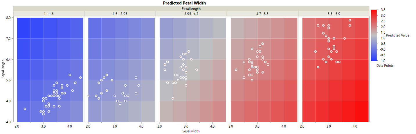

For this situation I prefer to output the profiler predictions in a factor grid and then plot them along with the original values.  This gives more flexibility and more information than was in the profiler.
An example of what this might look like, here the center of each dot shows the actual petal width:
