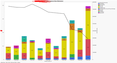

Hello, I am trying to put together some complex charts for my company and I have run into an issue. I have to show a certain value for multiple categories over the span of a dozen quarters (see image below). I want to be able to order the categories in my stacked bar chart by the value in my y-axis. In this example, I would want the non-fail category to be on the bottom of the stack followed by application category and so on and so forth.
I know that I can manually assign the stack order but that is not robust enough for my purposes. I have local data filters that, when used, will change the value of the categories and then they will need to be manually restacked again.
I have talked with the JMP experts assigned to my company and they told me that there wasn't a built in functionality for this yet which is why I am writing this post.
What is the improvement you would like to see? Please describe the idea for improving JMP. Please include mock-ups, wireframes, screenshots, scripts, other documents or examples from other software that help describe the change you would like to see.
Just like how you are able to order the x axis bars of the bar chart by descending/ascending order of the overlay values (see below). I want to be able to order the overlay stack in the same manner.
Why is this idea important? Please describe the value to you and/or other users if the idea is implemented (for example, ease of use, must have,…).
This seems like a must have for a graph builder. Being able to order your data by values that are displayed on the graph should be easy to do and is something I would think a lot of people would expect JMP to have.

Hey @Sarah-Sylvestre . I know of this functionality but it does not work for me. The values you can reorder your overlay by are the number of row entries it is in from the table and not the by the value of the y-axis. For example, look at the image below. I have highlighted the memory category. Its value shows 20, which means it has 20 rows from the table that are being used for the chart. Looking at the bar chart, you can see that the PPB value far exceeds 20. This is where the problem comes up. I may have a category that only calls on a single row but has a PPB value of 1000. i hope this explains the issue better.
AttributedMouse
Level II
Hey @hogi , thank you for responding. However, ordering the column on my table won't help either. My local data filter is filtering out a lot of data for this graph, therefore I need to be able to pull the PPB values straight from the chart as they are seen so that I can configure my overlay based on the sum of each category. You wouldn't happen to know how to do that would you?

Ok, I think I understood now.
you want to use a data filter to dynamically select some subset.
Then, for the specific subset, you want to order the entries in the bar chart in descending order - to focus on the main contributors on top.
Hm, one issue with "order by": you have the PPB information for 16 Quarters, but just a single setting for the order.
How should the 16 datasets be combined to define the order? separate order for every pile of bars? and using the sum to specify the order for the legend?
Maybe good as starting point - other options could be selected from a list of options.
-> Kudo from my side.
Maybe, originally, this ambiguity was the reason why the developers did not provide a "order by" for the Overlay?
