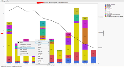

Hello, I am trying to put together some complex charts for my company and I have run into an issue. I have to show a certain value for multiple categories over the span of a dozen quarters (see image below). I want to be able to order the categories in my stacked bar chart by the value in my y-axis. In this example, I would want the non-fail category to be on the bottom of the stack followed by application category and so on and so forth.
I know that I can manually assign the stack order but that is not robust enough for my purposes. I have local data filters that, when used, will change the value of the categories and then they will need to be manually restacked again.
I have talked with the JMP experts assigned to my company and they told me that there wasn't a built in functionality for this yet which is why I am writing this post.
What is the improvement you would like to see? Please describe the idea for improving JMP. Please include mock-ups, wireframes, screenshots, scripts, other documents or examples from other software that help describe the change you would like to see.
Just like how you are able to order the x axis bars of the bar chart by descending/ascending order of the overlay values (see below). I want to be able to order the overlay stack in the same manner.

Hey @Sarah-Sylvestre . I know of this functionality but it does not work for me. The values you can reorder your overlay by are the number of row entries it is in from the table and not the by the value of the y-axis. For example, look at the image below. I have highlighted the memory category. Its value shows 20, which means it has 20 rows from the table that are being used for the chart. Looking at the bar chart, you can see that the PPB value far exceeds 20. This is where the problem comes up. I may have a category that only calls on a single row but has a PPB value of 1000. i hope this explains the issue better.
