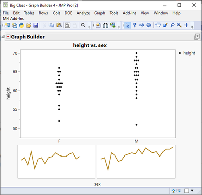

Trying to combine Box plot / Bar Chart / Grouped point plot with Line plot in separate graphs.
What is the improvement you would like to see?
Now that we have capability to add lines with Caption Box, maybe we could also add plots with it? Few plots I would be interested in using are the same we can utilize in Graph Builders header graphs, especially Run Chart. Below is a quick idea of what I mean
The empty space in F category shouldn't be there as those should be scaled by the groups rows not all rows.

Such a plot could also be generated if there was a possibility to disable X variables (use name for the below plot, disable name for the plot on the top)
https://community.jmp.com/t5/JMP-Wish-List/Graph-Builder-new-option-global-fit/idc-p/771637/highligh...
