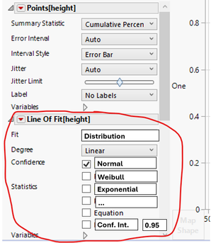

What I’d propose again is to add Distribution Fitting w/ Confidence Intervals to Graph Builder, similar to the “Life Distribution” module.
(And sorry that the post may gonna become a bit long, but I’d like to show the “reasoning”.)

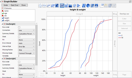

Big Class.jmp
CDF in Graph Builder possible but only w/ lines, not data points

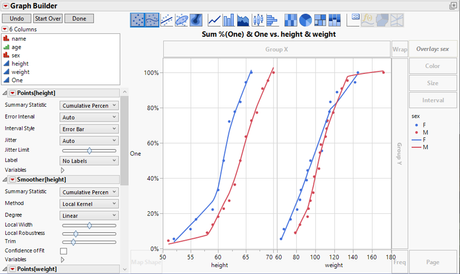

Adding a column w/ 1s to Big class.jmp
Now CDF in Graph Builder w/ points is possible

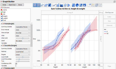

Using Smoother even a “Guide to the eye” fitted line can be added in Graph Builder.
A real “Line of Fit” for a distribution is not possible (or at least I did not manage :-)).
And moreover the “Confidence of Fit” can be added

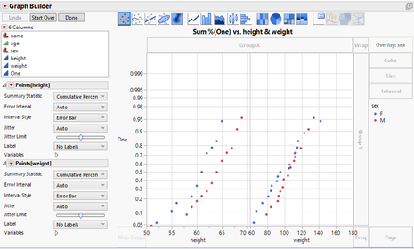

It is also possible to use Probability Scales like Normal or Weibull instead of Linear.
(Works only w/ lines or points, though, Smoother lines and Confidence shapes are removed when changing the Y-axis scale.)

What I’d propose is to enhance the “Smoother” or better the “Line of Fit” option to fit actual distributions to the data points.
Could be under “Fit” and then a selection of the actual distribution.
And an option to add and set the Confidence Interval.
