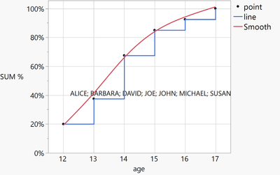

hogi
Level XIII
The approach even works for Smoother plots - if there are not multiple rows with the same value.
As @XanGregg  mentioned, Cumulative Percent sets the single point per x value to the max.
Therefore, the smoother curve runs with a slight offset to the actual curve.
Maybe add a setting which allows the user to choose between
- max (like now)
- midpoint (like Prob Scores in Distribution)
- individual points (like standard Col Rank)
- min (if somebody needs this as well)
besides that, at the moment, it's not possible to label individual rows:
Names Default to Here(1);
dt << Select Rows( [9] ) << Label;
Graph Builder(
	Transform Column( "one", Formula( 1 ) ),
	Variables( X( :age ), Y( :one ) ),
	Elements(
		Points( X, Y,  Summary Statistic( "Cumulative Percent" ) ),
		Line( X, Y,  Connection( "Step" ), Summary Statistic( "Cumulative Percent" ) ),
		Smoother( X, Y,  Summary Statistic( "Cumulative Percent" ), Lambda( 0.12 ) )
