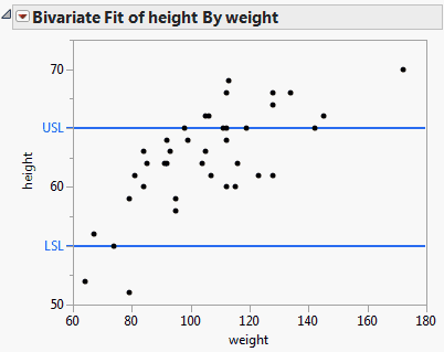

The graph contains the reference lines indicating the specification limits for the column. You can clearly see which data falls within the specification limits.
Graph Showing Reference LinesGraph Showing Reference Lines
