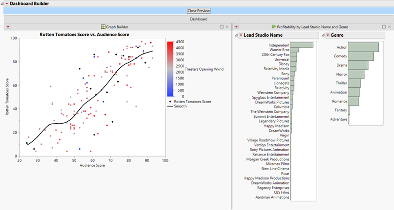

  4. From the Reports pane, double-click each open window to place it on the dashboard.
  5. From the Dashboard Builder red triangle menu, select Preview Mode.
  6. The reports are combined in a single dashboard window.
    Dashboard BuilderDashboard Builder
  7. Select File > Save As and save the dashboard as a .jmpapp file.

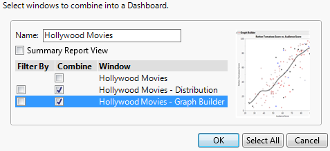

  1. Open the windows that you want to combine.
  2. Select Window > Combine Windows.
  3. Name the dashboard.
  4. Select the windows that you want to combine.
  5. Combined WindowsCombined Windows
  6. Click OK.
  7. The reports are combined in a single dashboard window.
  8. Select Edit Dashboard from the red triangle menu and then save the dashboard as a .jmpapp file.
