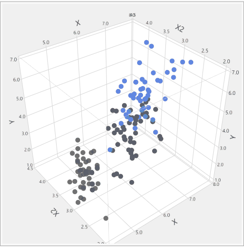

You can animate the spinning of a 3D scatterplot in any of these ways:
  • To spin the scatterplot at a certain speed, hold down the Shift key, click and drag an empty area on the plot, and release Shift. The faster you drag the mouse, the faster the 3D scatterplot spins.
  • To spin the scatterplot in a certain direction, hold down the Shift key and press an arrow key, and then release Shift.
To stop the animation, press Esc.
