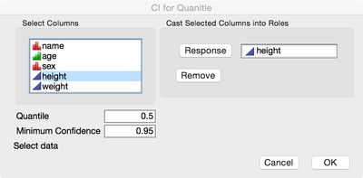

I will use the Big Class data table to demonstrate how to use this script. I will first estimate the 95% confidence interval for the median of the height of students and then estimate the 80% confidence interval for the 75% percentile of the weight of students.
  • Open your data table with the data column containing the sample.
  • Open and run the script.

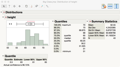

  • I desire a 95% confidence interval for the median, so enter 0.5 for the quantile (default) and 0.95 for the confidence (default).
  • Select height and click Response.
  • Click OK.
You see the additional information at the bottom of the platform. Note that the actual confidence is reported with the interval.

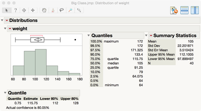

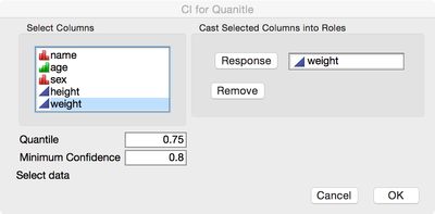

  • Enter 0.75 for the quantile and 0.8 for the confidence.
  • Select weight and click Response.
  • Click OK.

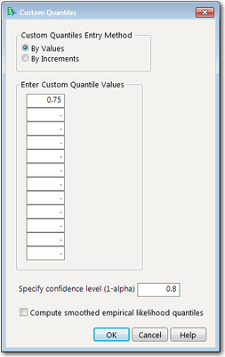

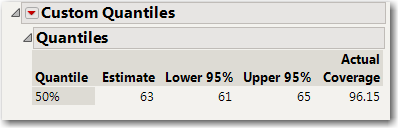

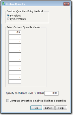

I also wanted to let JMP users know that in versions of JMP 10 or higher, you can also get these quantiles and confidence intervals within the distribution platform. Using the same data table as Mark, you could get these reports for height and weight by selecting Display Options > Custom Quantiles.  You enter the quantiles you would like to calculate in the entry column and then set the confidence level.  Here is what I enter for height:
Here are the JMP results:
Here is what I enter for weight:
Note that I am using JMP 12 for this example.  The "Compute smoothed empirical likelihood quantiles" check box is a new option for JMP 12.  In JMP 10 and 11 the empirical likelihood quantiles and confidence intervals are always computed in this report.
