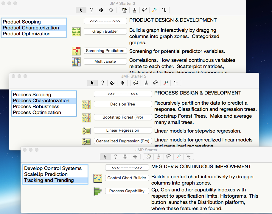

Attached is the Master JMP File (CustomStarterSpecFile-QbD.jmp) used to make a JMP Custom Starter Menu that orients tools common used in a QbD (Quality by Design) flow.  QbD is a process to achieve breakthroughs in products, services, and processes that was first devised by Quality Guru Joseph Juran and is commonly used in automotive and pharmaceutical industries (source: Wikipedia).
This Customer Starter menu surfaces the commonly used JMP and JMP Pro tools for a typical Pharma QbD flow covering:
- Product Design & Development (Product Scoping, Product Characterization, Product Optimization)
- Process Design & Development (Process Scoping, Process Characterization, Process Robustness & Process Optimization)
- Manufacturing Development & Continuous Improvement (Develop Control Systems, ScaleUp Prediction, Tracking & Trending).
One can modify and edit this Master File to create your own Custom Starter Menu flow. Once the table is ready, you merely have to run the "Create Custom Menu Script" on the Master File to generate the needed Menu Section Scripts. These Scripts can then be copied into a JMP Add-In to create an easy to share Custom Starter Menu that will load onto the users Add-In Menu. The finished JMP Add-In can be accessed at the following link: https://community.jmp.com/t5/JMP-Scripts/JMP-Custom-Starter-QbD-Quality-by-Design-for-Pharma-Menu-Ad...
This menu was created with instructions from Brady Brady's article, "Fast and Easy Custom Menus in JMP": https://community.jmp.com/t5/JMP-Add-Ins/Fast-and-Easy-Custom-Menus-in-JMP/ta-p/24054
This add-in was also featured in the recorded JMP Discovery Summit 2016 presentation, "Creating Your Own Dynamic Workflow with JMP Custom Starter Menus": https://community.jmp.com/t5/Discovery-Summit-2016/Creating-Your-Own-Dynamic-Workflow-With-JMP-Custo...
