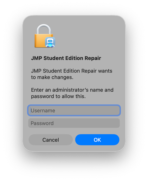

Step 3: Enter administrative credentials for MacOS and click OK.

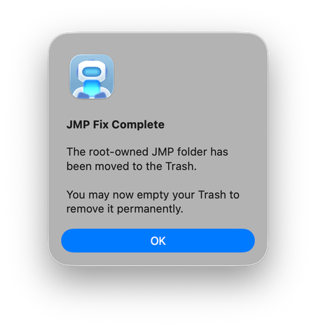

Step 4: Click OK to confirm completion.
