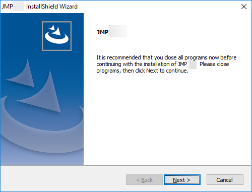

a. Click Next at the InstallShield Wizard window.
Figure 2Figure 2

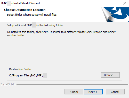

b. Click Next at the Choose Destination Location window.
Figure 3Figure 3

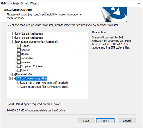

c. Click Next at the Installation Options window.
Note: These options are explained below:
  • Language Support Files (Optional) – Installs the language files needed if you plan to operate JMP under different display languages.
  • Excel Add-in – Installs the JMP Excel Add-In within Excel.
  • SAS software integration – Installs the JAVA components needed to connect to a remote SAS server from JMP.

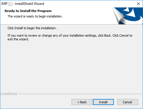

d. Click Install.
Figure 5Figure 5

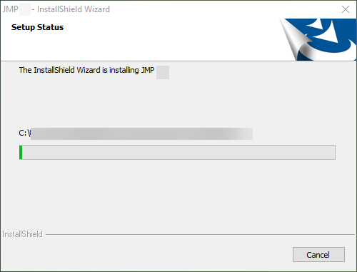

e. Wait for the installation to complete at The InstallShield Wizard is installing JMP <version> window.
Note: JMP installs Microsoft .NET, Microsoft Visual C++ Redistributable(s), and other JMP support files.

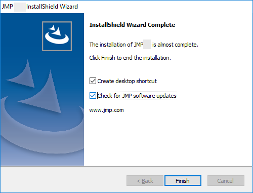

f. At the InstallShield Wizard Complete window, select whether you want to Create a desktop shortcut and/or if you want JMP to Check for JMP software updates.
Figure 7Figure 7
g. Click Finish.
