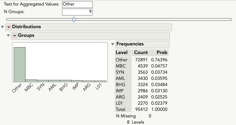

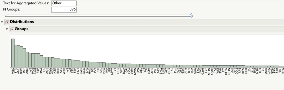

There are a number of different ways we can aggregate low count groups: by absolute number of observations, relative number of observations (e.g., groups with counts less than 10% of the largest group), fixing the total number of groups, etc. Each has its merits and shortcomings. To provide a flexible solution, I choose to go with an approach that was both interactive and visual, managed with a bar chart that was adjustable using a slider. This way, I could move the slider back and forth until I found a distribution of groups that looked good. The difficulty was coming up with code that was fast when the number of groups was large. To make it simple, I wanted to work with Data Table operations and Platforms (with Automatic Recalc turned on). Below is an example of what this might look like before and after:
Before
After
Generally speaking, this code works by building a summary table from the groups and using the group counts (the N Rows column) as a Freq variable. This circumvents the need to update values from the original table, which may be considerably larger. The code can be found in Aggregate Groups.JSL. A list of the original group values from the summary is stored in the global variable groups in addition to a vector rank order of the counts (ranks). Moving the slider runs the aggregateLowCounts functions where the request number of groups (nGroups) is passed based on the position of the slider. The number of groups can be easily selected from ranks vector. For example, if 10 total groups are desired, the value for any original groups with a rank 10 or greater is set to the aggregated group value (e.g., “Other”) with all other groups remaining the same. Because the table is sorted, this merely requires changing values from row 10 onward.
