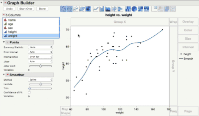

Jeff_Perkinson
Community Manager
@JanneI, the trick here is to apply your customization graphics script before you drag your column to wrap.
