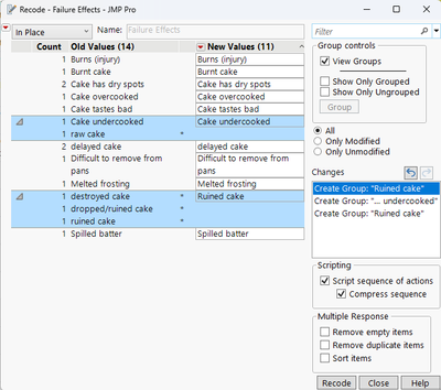

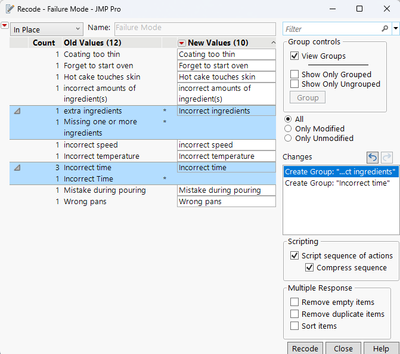

  • Recode: As a first example, the Recode tool allows for quick detection and correction of misspelling, as well as combining similar entries, which immediately results in updated header graphs:
    • Jed_Campbell_7-1719592439796.pngJed_Campbell_7-1719592439796.pngJed_Campbell_8-1719592565302.pngJed_Campbell_8-1719592565302.png
    • In this case, selecting the most common failure modes in header graph interactively shows the top failure effects. Purchasing timers for the process would be a good improvement action, since it would target multiple failure points at once.
