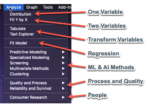

Let's think about how people generally analyze data ... well, let's think about how they should analyze data. When people get a new data set, the first thing they should do is create a graph of some sort. If they don't want to make any assumptions about relationships, they would use histograms. If they looked at the first item in the Analyze menu, they'd find something called Distribution. Can you guess what chart they would get for free in Distribution? Right! It's a histogram! This would help them understand the shape of the data, look for quality issues, etc. (more on that in the next bit).
Next, after studying the distributions of their data, they should start to consider how things might relate. This would usually start by comparing one response and one factor – bivariate relationships. They may want to look at ANOVAs, logistic relationships, lines of fit, etc. That's all in Fit Y by X. In short, if the question you are trying to answer involves one column of data, then choose the first position on the Analyze menu (Distribution). If the question you are trying to answer involves two columns of data in relationship in some way, choose the second position on the Analyze menu (Fit Y by X). Dozens of appropriate statistics almost magically appear if you map the first two items on the Analyze menu with the number of columns referenced in your question.
It would seem that, at first, the pattern is to arrange the menu by order of how many variables are being compared. After Fit Y by X, that pattern appears to break. The trick to understanding the Analyze menu is that it's not ordered by the number of variables being considered, but by the complexity of the problems the menu items address. That's why Consumer Research is at the bottom – people, as a whole, are nuts, and data involving people is, invariably, incredibly complex.
So, that would seem to explain the top and bottom part of the menu, but what about the middle? Tabulate (and Text Explorer) appear to be in an odd spot. However, if you consider that they are primarily transformative tools, their position makes more sense. Tabulate is a great way to summarize data for further analysis. Text Explorer's job is to take free text and convert it into something that the other analytical methods can handle. So, they are bridging tools used to go from one level of analytical complexity to another.
Here's a little graphic to help you remember:
