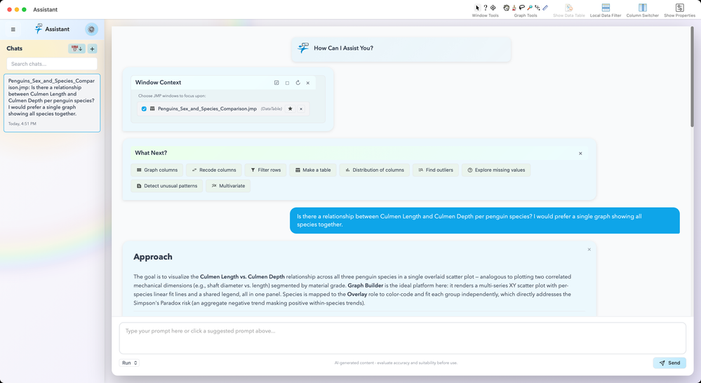

A student wants to explore the relationship between bill dimensions across penguin species, so she types in: Is there a relationship between Culmen Length and Culmen Depth per penguin species? I would prefer a single graph showing all species together.”
Step 1: Assistant recognizes the open data set and open analyses; it explains its analytical approach before running anything.
Assistant responds first with an Approach, explaining that Graph Builder is the right platform for a multispecies overlaid scatter plot. It also flags the Simpson’s Paradox risk: an aggregate negative trend can mask positive within-species trends. The student sees the reasoning before the result.
Then it runs. The scatter plot appears in JMP Student Edition with per-species regression lines and confidence bands.
