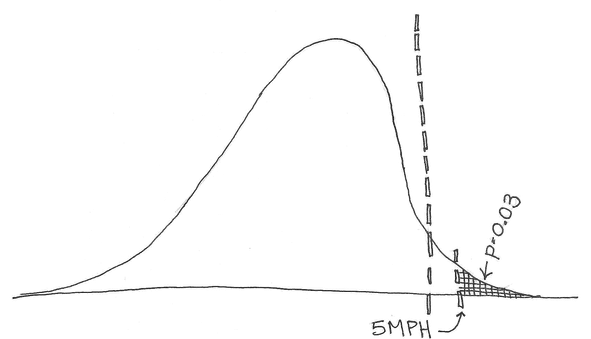

forScience.pngforScience.pngThen I ask “if there were no difference between African and European swallows and I just grab some birds at random, what percent of the time am I going to get two groups of swallows with an average difference greater than 5 mph?” The probability of that happening is my p-value: the probability of getting a value as extreme or more extreme than my data — assuming that the null hypothesis is true.
But how do we know how likely all these things are? For each test statistic, we have a distribution. To name a few, we have a z-distribution, t-distribution, F-distribution, and Chi squared-distribution. All of them have different shapes — some even change depending on how big our sample size is — but they all tell us the relative probability of getting all the different values for each test statistic.
So we calculate a test statistic — say a t-value — based on our data and then mentally draw a line at that value. Our p-value is the proportion of the distribution that is more extreme than that line.

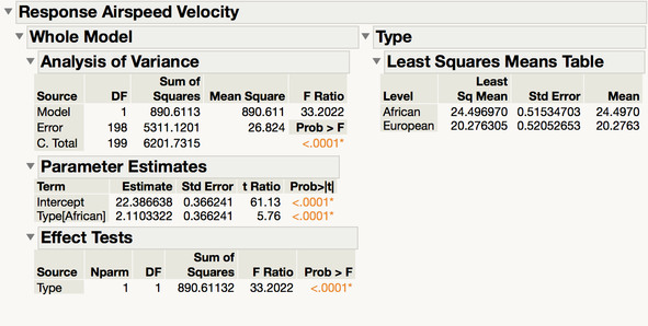

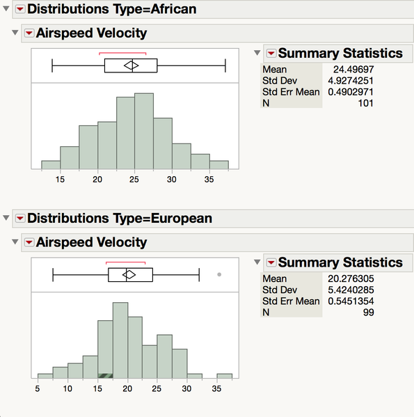

When you're looking at an ANOVA on Airspeed Velocity and see a significant effect of swallow type, you can use the Analyze>Distribution platform in JMP or the Calculate Effect Sizes Add-In to look at the effect sizes of your data as well. (JMP file attached; #AfricanSwallowsForAllCoconutTransport.)
