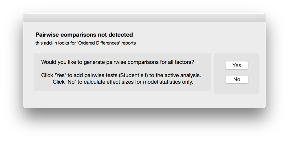

  • If pairwise analyses (e.g. Student's t-test) and "Ordered Differences' reports are available, Cohen's d including confidence intervals for available pairwise effects will be calculated and saved to a combined data table
  • If no pairwise analyses have been produced (or "Ordered Differences' reports have not been produced) a prompt will appear to add these analyses and calculate these effect sizes.Screen Shot 2018-03-21 at 1.49.27 PM.pngOutput:

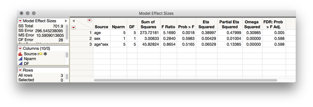

    • Table of model effects, effect sizes, and False Discovery Rate adjusted p-Value.Screen Shot 2018-03-21 at 1.50.18 PM.png

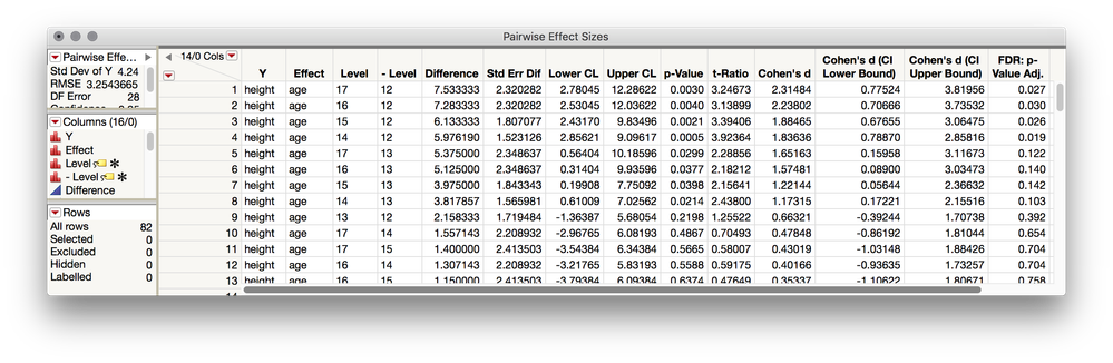

      If requested, table of pairwise effect sizes, confidence intervals, and False Discovery Rate adjusted p-Values.Screen Shot 2018-03-21 at 1.51.07 PM.png

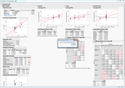

I keep getting this error message. What should be selected? The output of the Fit Least Squares output is my active window (On a PC).
There appears to be some differences in window naming on the windows and mac -- working on a fix for this now.
Done! Rather than using the active window the new version searches the open windows for least squares reports. If only one is available that report will be used, otherwise a dialog will appear to select which least squares report to use.

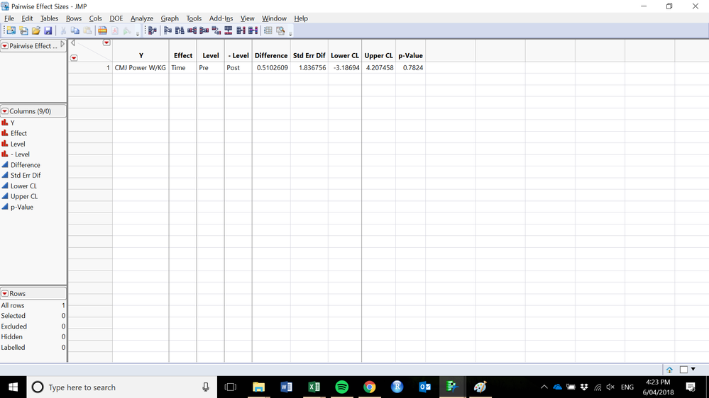

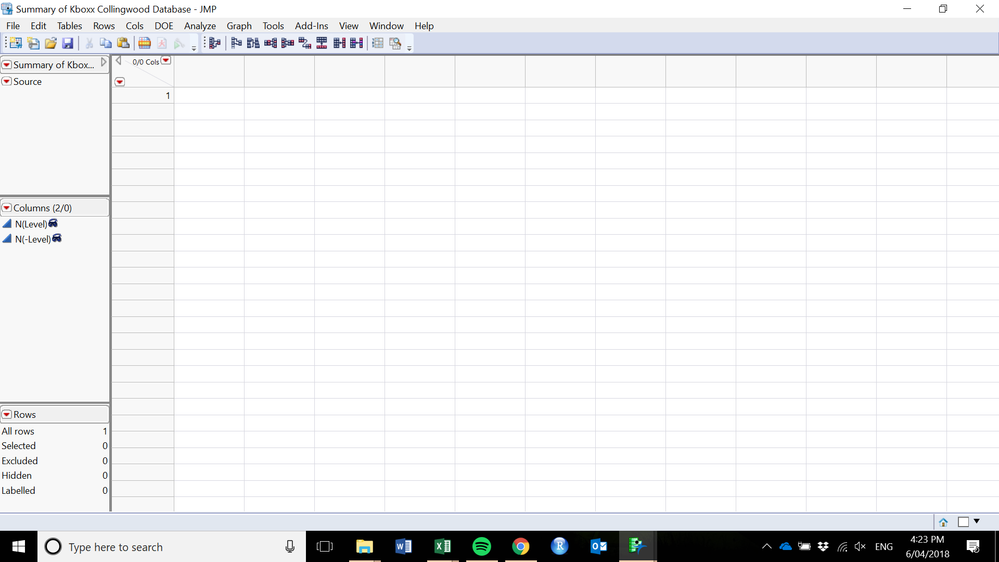

Hello,
I have used this on previous versions and just updated to 07 and now I dont get the ES calc (see pics). Also the summary data table doesnt collate either. I used the same steps as I had previously with the add-in (which I found great by the way). Yet no love on this attempt
Just wondering if there is something I am doing wrong? I have un-installed the add in and re-installed...no love.
Any help would be greatly appreciated.
CheersES OutputES OutputSummary tableSummary table
