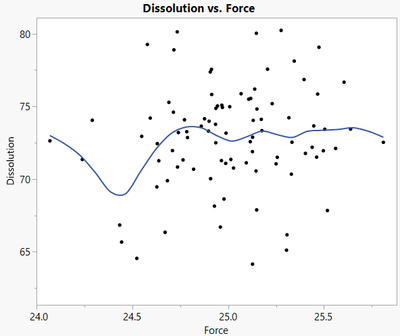

In the example below, I will be using the sample set attached to this blog. I have a scatterplot with a smoother for my process output, Dissolution, versus one of my process inputs, Force.

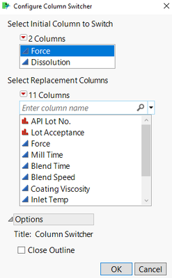

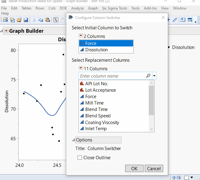

When I click on the Column Switcher icon, a new window appears.
From here, I select Force as my initial column to switch, and then I select all my process inputs as my replacement columns. I will also change my title to “Process Inputs.”

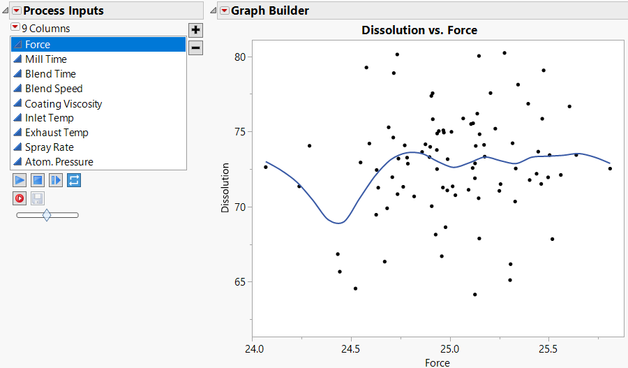

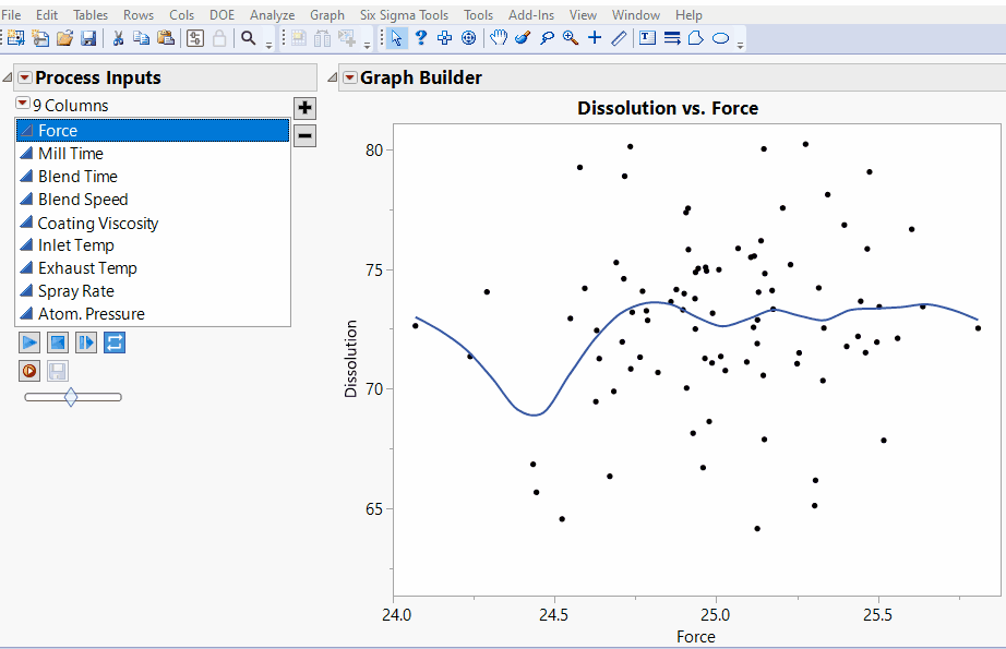

After clicking OK…Boom! A Column Switcher is added to the left of your graph.

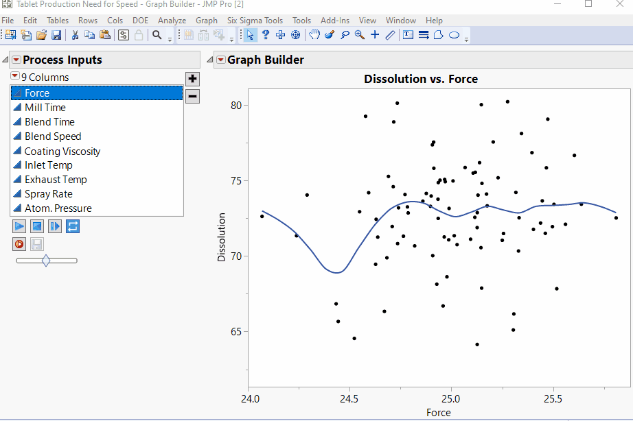

Watch as the graph instantaneously and dynamically updates as I click on different process inputs! I could have also chosen to use my up and down arrow keys to toggle between my different process inputs. The best part is it’s all in one window!

    Absolutely! To the right of the Column Switcher, you will notice “+” and “–” buttons, which can be used to add or remove variables respectively.
  2. Can I use the Column Switcher to create an animation or slideshow?
    Absolutely! Below the Column Switcher is a set of commands to do just that! Watch as I click the play button and change the speed of the toggling between variables by moving the slider.
I can also choose to have my looping disabled by deselecting the below symbol:
Additionally, I can record and save the animation as a gif using the below symbols:
