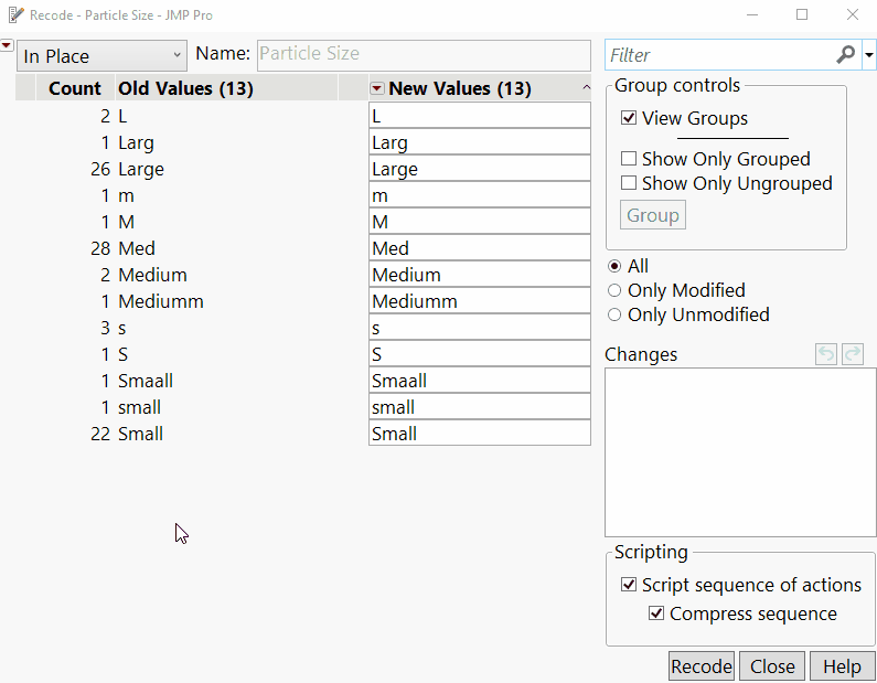

In the example below, I am interested in a Particle Size variable where I should only have values of Large, Medium, and Small. However, you will notice that I have some typos (ex: Larg, Mediumm, Smaall, etc.) and different notations for the same value (ex: S, s, and small for Small). Each of these would be considered separate and unique in your analyses, which is unacceptable!

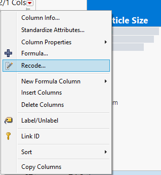

With JMP, there is no need to manually go through each row and fix the typos or standardize the notation style. Just right-click the column of interest and select Recode.
A new window appears. In this window, you will have all your current values displayed under the Old Values column. In this example, we have 13 different values for Particle Size when there should only be three. You will see the number of appearances for each value in the Count column. For example, we have 26 instances of the value Large in our table.

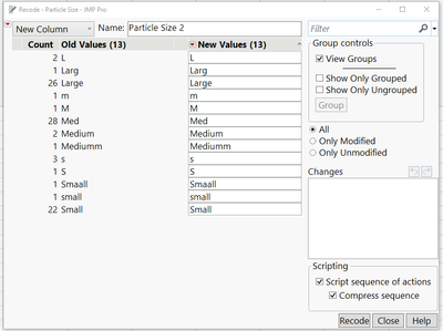

There is a drop-down menu in the top-left corner of the window, where you can choose to create a new column with new values, a formula column, or replace the values in the current column with In Place. For this example, we will be using In Place.
We can select multiple of the old values and group them together by clicking on the Group box to the top-right of window. The default new value will be the old value in the group that had the highest count. However, you can always change the new value by clicking on it and typing something different.
In the example below, watch as I group the 13 old values into three new values of Large, Medium, and Small.

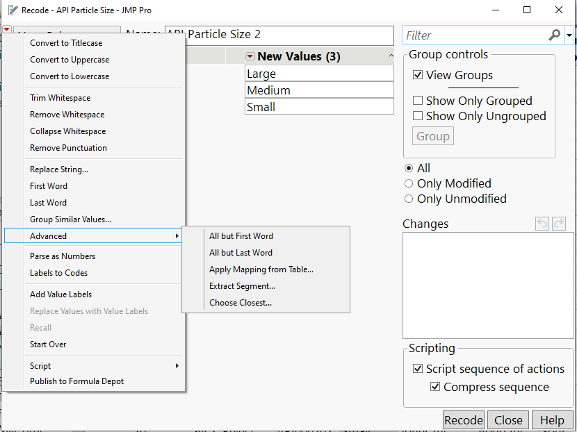

Tip: Clicking on the red arrow at the top-left of the Recode window has shortcuts for fixing common structural errors such as converting characters to title case/lowercase/uppercase, removing whitespace or punctuation, extracting or replacing part of a string .

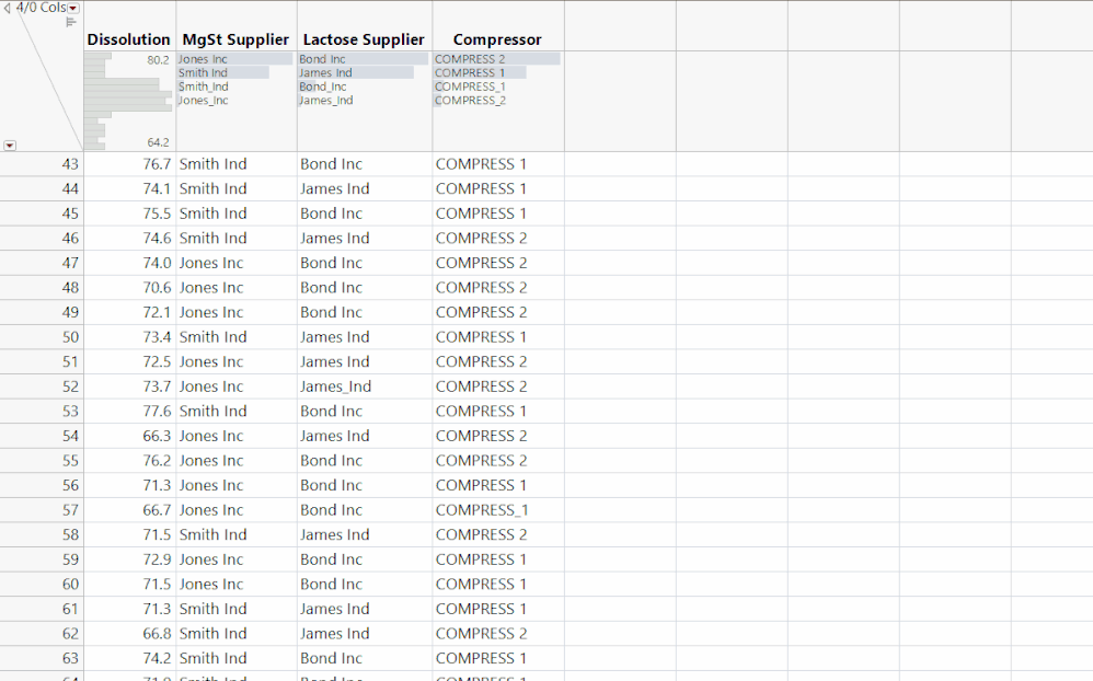

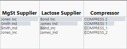

In the example below, we have several categorical variables that have structural errors.  The presence or lack of an underscore to our strings is creating separate unique values.
An easy way to standardize the values and solve our problem would be to use the Replace String… option of Recode under the red triangle. You can choose to replace the space with an underscore or vice versa.
In the example below, watch as I use the Standardize Attributes feature and the Replace String… option to clean the data and replace a space with an underscore.
