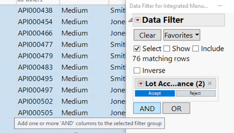

To filter data by more than one variable, I recommend using JMP’s Data Filter. All you need to do is go to Rows>Data Filter or just click on the following icon:
You can then double-click on a variable of interest and select a desired value or range of values. To incorporate more variables, click either the “And” or “Or” functions at bottom.
In the animation below, you can see how to create a subset based off the following conditions: Sugar Supplier equal to “Sour” and Mill Time between 10 and 20.

GeneratingModes
Level I
Is there a way to select rows using multiple numeric variables by keying in a range rather than picking graphically?  This would be more efficient when a large number of variables are involved.
jthi
@GeneratingModes (Global) Data Filter is one option
You could also create a formula and select values based on that.
cweisbart
Staff
@GeneratingModes great question! The 3rd gif in the blog shows an example of how to key in a maximum and minimum filter value for Mill Time instead of manually using slider. Hope this helps!
