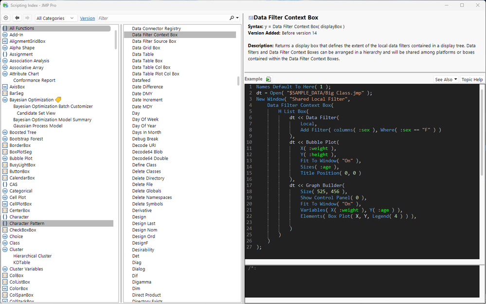

In short, having one local data filter work on multiple outputs requires something called a data filter context box, which requires some scripting. The JMP Scripting Index (Help > Scripting Index > Data Filter Context Box) already has an example that shows how it works.

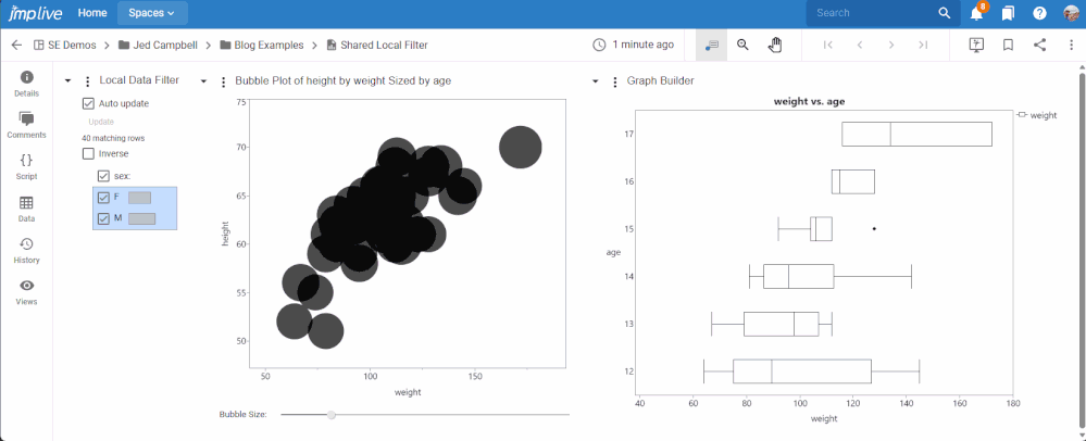

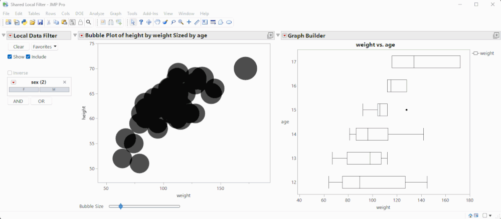

When I run this example, I get a new window with a local data filter on the left, and a bubble plot and a Graph Builder on the right. Interacting with the local data filter changes both of the other items in the window.
When this window is uploaded to JMP Live, the same filtering behavior happens:

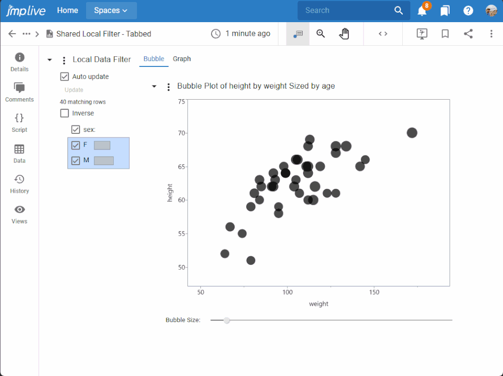

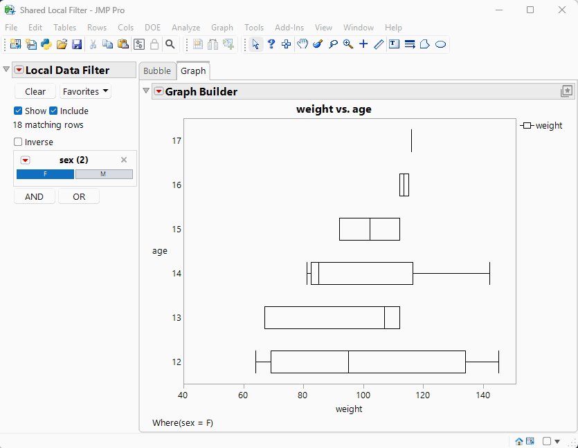

Running this script makes a tabbed interface, where the local data filter affects both tabs.
Uploading this to JMP Live shows the same tabbed interface, with the same data filtering behavior.
