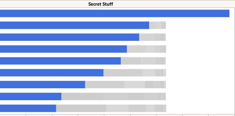

Cool! I ran it a few times and found it to be a great alternative to pareto plots. I work in maufacturing improvement. We use top10 charts a lot to help drive us to work on the right things. With the current pareto platform, one must use combine last (n-10) causes to see the top 10. The detail of the (n-10) causes gets buried. The packed bars gives me a nice pareto with details on demand of a treemap.
How does one control the bar width/spacing? My bars had vertical spacing between them.

Unfortunately, you can't readily control the bar spacing in JMP 13. There are some tricks if you really want to get the effect, but otherwise the script only approximates the packed bars look.

p.s. I used packed bars to analyze and present the secret stuff from above last month. Worked much better than a standard pareto!

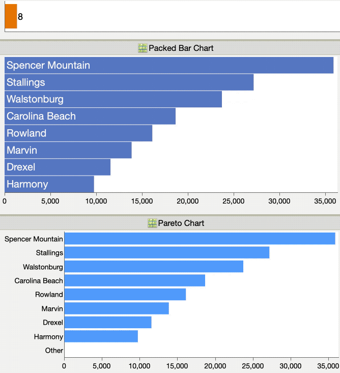

Thanks, Mark. Speaking of Pareto, I recently made an animated gif comparing packed bars and Pareto as the number of values grows.
