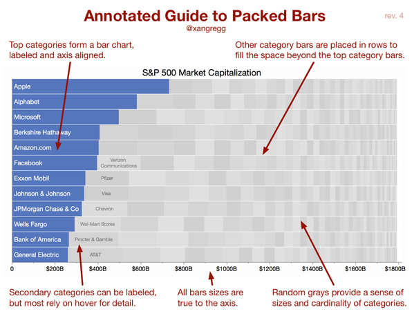

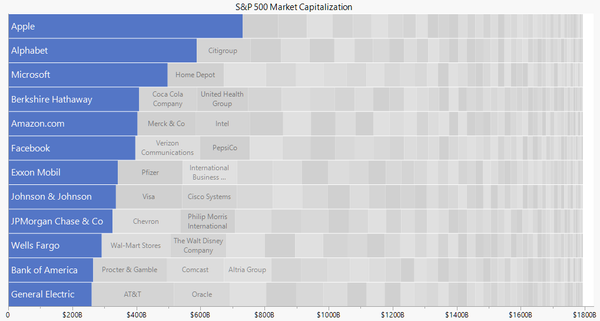

How do you visualize skewed data over hundreds of categories? I’ve been experimenting with a new chart form that could help with this. I'm calling it “packed bars.” It's a synthesis of an ordered bar chart and a treemap. Here’s what a packed bar chart looks like with recent S&P 500 market capitalization data.
The blue “primary” bars and the axis form a regular ordered bar chart showing the 12 largest companies by market capitalization. Each gray “secondary” bar represents one of the other companies. Some of the secondary bars can be labeled if space permits, but their main purpose is to provide context for the primary bars. The idea is to support the Focus+Context data visualization principle.
We can get a rough sense of how many secondary categories there are, what their total size is, and even how the sizes are distributed. And since they are on the same scale as the primary bars, we can even estimate some of the values from the length they span on the axis. In a dynamic display, category labels and values for secondary categories can be accessed via hover labels.
The right edge doesn’t always come out so even, but by placing the larger secondary bars first from left to right, it usually works out pretty well.

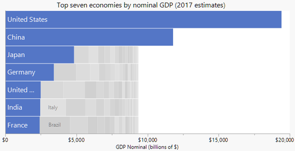

Sometimes the values are so skewed that the secondary fill doesn’t surpass the primary bars. That’s the case when charting world economies by nominal GDP. This packed bar chart highlights the top seven of 192 world economies. (Not the quite same as the G7, by the way).

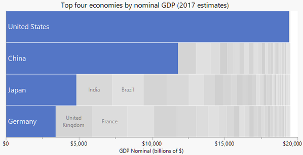

Choosing only four primary categories highlights the fact that the US economy is about a fourth of the world nominal GDP.

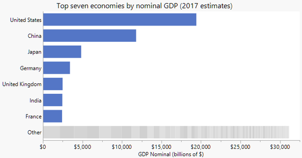

If the sum of the secondary categories fits in the same scale as the primary bars, they can be packed into a separate bar like this.

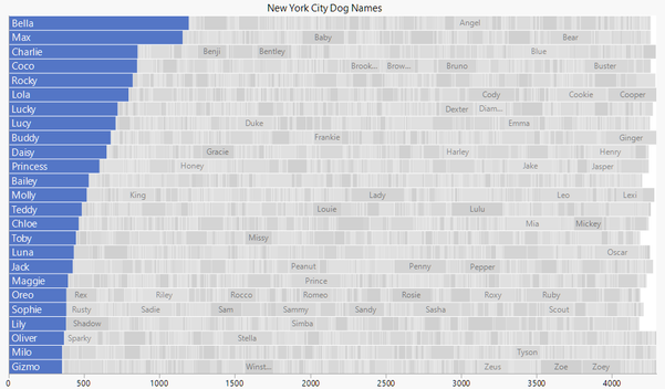

The data set that started me down this path was a collection of New York City registered dog names. Here is my creation highlighting the top 25 of more than 16,000 names.
Unlike the other packed bar examples, the secondary categories were placed alphabetically and row-by-row to support looking up a particular dog name (with the help of hover labels). The downside of this arrangement is that the right edge is noticeably less even.
An advantage of having a true x axis (unlike a treemap) is the ability to estimate the grand sum for the entire population. In this case, we have 25 rows, and each goes to just over 4,000 on the count axis. We can estimate the number of dogs at 25 x 4,000+ = 100,000+.
The nicardipine example showed the use of a continuous color scale for the bars. With categorical coloring, the fading is less likely to complicate the color interpretation. In this view of the dog names, I used orange for names that end in a “y” sound.

Annotated guide
This next picture is not for you; it's for those who skimmed the post looking only at the pictures.slightly-smiling-face.png
