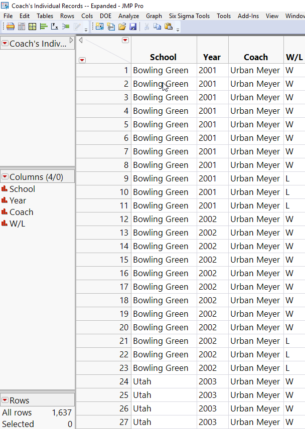

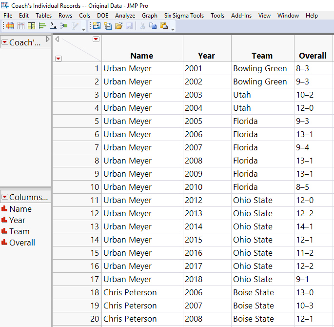

Before I could perform the analysis, I had to make some changes to the data format. The original data set looked like this:
Figure 1: Coach’s Individual Records, Pre-Modifications. (File attached to post.)Figure 1: Coach’s Individual Records, Pre-Modifications. (File attached to post.)What JMP needs for the analysis is a row for each game played, including a designator of whether the game was Won or Lost. The end result looked like this:
Figure 2:  Coach’s Individual Records, Expanded to One Row Per Game.Figure 2:  Coach’s Individual Records, Expanded to One Row Per Game.
To convert from the first table to the second, I first expanded each year’s Wins and Losses into two new columns in the original data table, and then I used a custom JSL Script to expand the table. For details on that, see Appendix A.

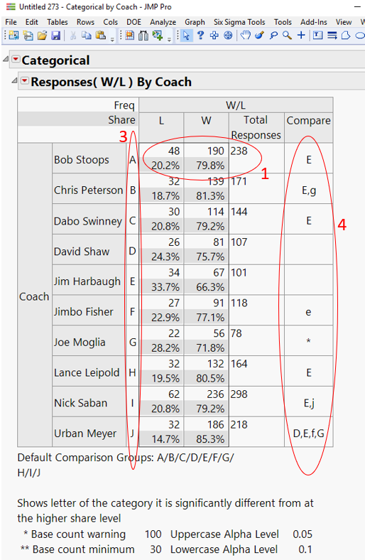

Running the reformatted data table through the Consumer Research tools in JMP (specifically the Categorical platform) gives us the results shown in Figure 3.
Figure 3: Contingency Analysis of Coaches’ Career Winning Percentages.Figure 3: Contingency Analysis of Coaches’ Career Winning Percentages.
The Contingency Table in Figure 3 shows the summary statistics (Wins and Losses), the Total Games (or Responses), and the Percent Wins and Losses for each coach. (See the red ellipse in Figure 3, labeled #1.) These percentages are depicted graphically in the bar chart below the table.
Below the bar graph, note the Pearson PValue (red ellipse labelled #2). The value is 0.023. We are interested detecting differences with at least 95% confidence. Since the PValue is less than 0.05, we are 95% confident that there is a difference between at least one of these coach’s W/L records and the remaining coaches.
But which coaches are different from which others? A simple evaluation would be to simply look at the W/L percentages, and rank order accordingly. But this does not consider the different sample size for each coach.
For this, we look at output table in Figure 3. Each coach is given an alphabetic label (A through J; see red ellipse labeled #3.) In addition, there is a column labelled “Compare” (see red ellipse labelled #4). Various coach’s “letters” are listed in this column. For example, the letter in the Compare column next to Bob Stoops is an “E”, referring to coach E, which is Jim Harbaugh. This indicates that Bob Stoops’ W/L record (79.8% wins) is statistically different than Jim Harbaugh’s (66.3%) over their careers.
However, since “E” is the only letter listed next to Bob Stoops, there are no other coaches whose records are different from Stoops’.
Similarly, Dabo Swinney and Lance Leipold have better records than Harbaugh’s.
Note that Jimbo Fisher has a lowercase “e” across from his name. Where the capital letters signify 95% confidence that there is a difference between two coaching records, lowercase letters indicate only a 90% confidence. So, considering the records and total games coached, we have only 90% confidence that Fisher’s record is better than Harbaugh’s.
Based strictly on W/L records, Urban Meyer stands out among these coaches, with 95% confidence that his record is better than David Shaw’s, Harbaugh’s, and Joe Moglia’s, and 90% confidence that his record is better than Fisher’s. We can’t tell (with at least 90% confidence) that his record is different from any of the other coach’s records.

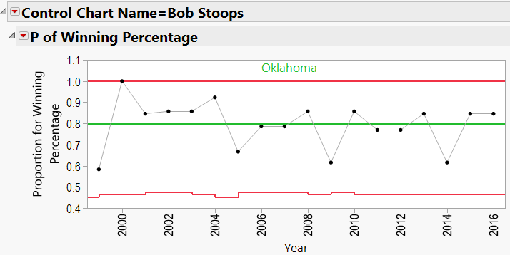

A2:  Are the coaches’ records consistent over their individual careers?

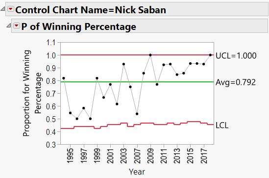

Using the winning percentage as my response, Number of Games as my Sample Size, Year as my Sample Label, and Coach’s Name as my “By” variable, I generated P-Charts for each coach. Appendix B shows all the charts. Let’s have a look at Nick Saban’s chart:

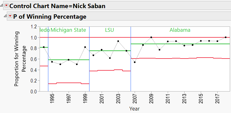

Figure 4: P-Chart of Nick Saban’s Coaching Results.Figure 4: P-Chart of Nick Saban’s Coaching Results.
Here we see that Saban has been coaching since 1994. The red lines in the chart indicate “Control Limits,” or the boundaries within which a process is considered “in control.” The top Control Limit is clipped at a value of 1.0 (or 100% games won). The lower limit varies between 0.4 and 0.5. Note that the variation is caused by different numbers of games coached each season. Also listed is Saban’s career winning percentage (0.792).
There does appear to be an upward trend to Saban’s record, beginning in about 2008 (after joining Alabama). We can add a “Phase” to the P-Chart indicating the school that he coached at:
Figure 5: P-Chart of Nick Saban’s Coaching Results, Including School Annotation as “Phase.”Figure 5: P-Chart of Nick Saban’s Coaching Results, Including School Annotation as “Phase.”Now we see that Saban’s record improved (both in average and in variation) as he moved from Michigan State to LSU to Alabama. Also note that his first year at ‘Bama seems to be an out-of-control “aberration.”

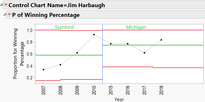

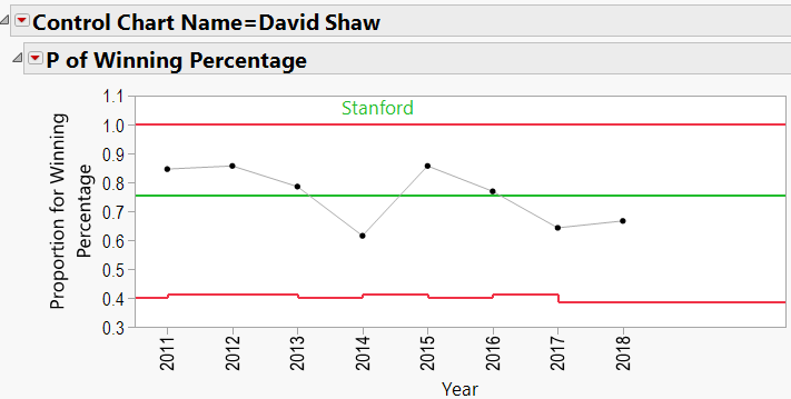

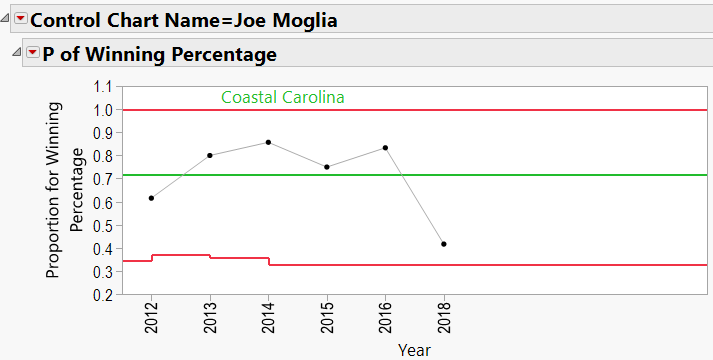

Looking through the other charts (Appendix B) shows similar charts for other coaches, with an occasional “out-of-control” year, and variations from school to school.

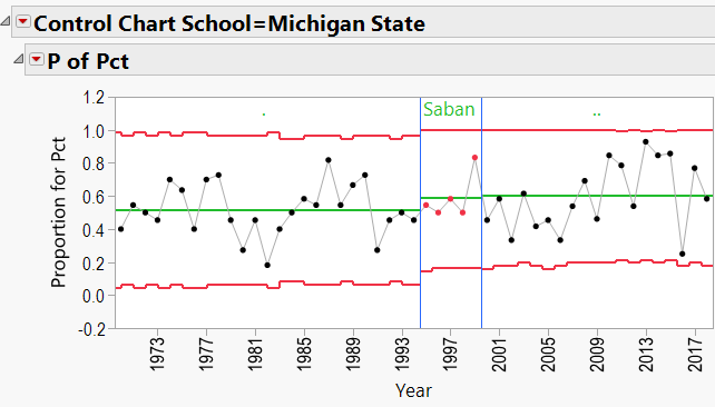

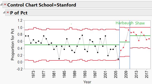

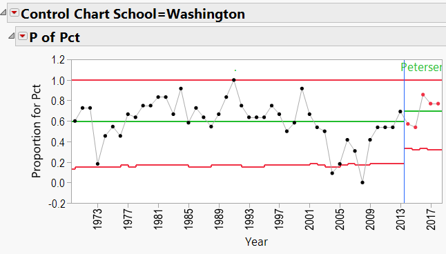

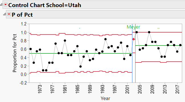

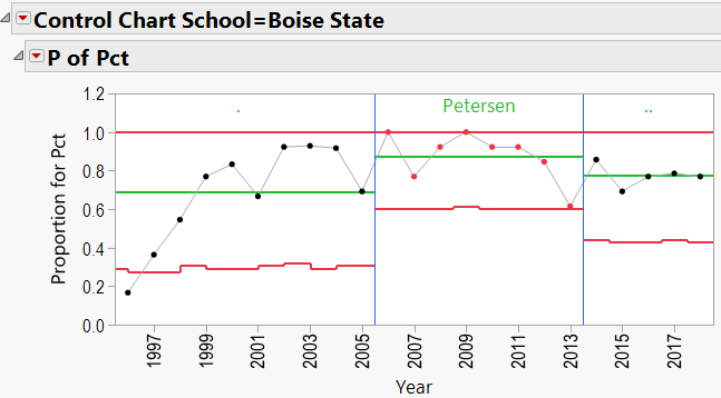

Q3: Does bringing in a specific coach help a school’s overall W/L record?
As mentioned in the discussion about coaching consistency, it appears that moving to Alabama was good for Nick Saban’s record. Can the same be said for the school’s good fortunes? In other words, can we say that Alabama benefited from hiring Nick Saban?

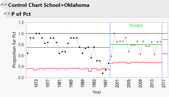

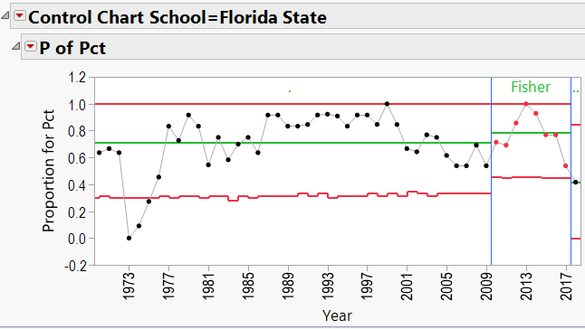

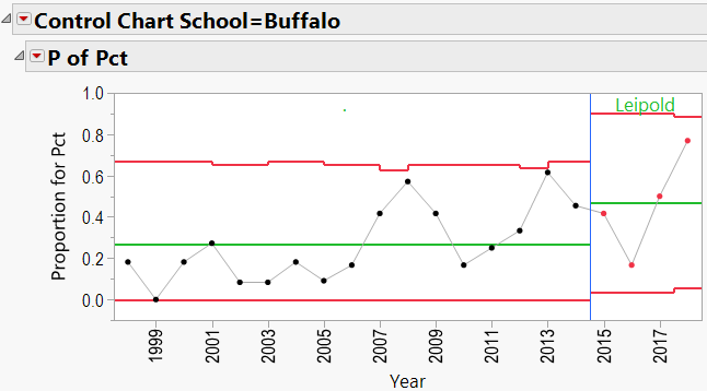

This is again a P-Chart question, but we need to flip the axes. First, I downloaded all of the W/L records for all schools coached by any of the 10 coaches in this study. I went back as far as 1970. This resulted in a data table containing columns of School Name, Year, Coach Name, Games Played, and Winning Percentage. I added a column called “Top Coach?” that  contained:
  • A dot (“.”) for any school/year that was not coached by one of my 10 coaches.
  • The coach’s name if the coach during that school/year was one of my 10 coaches.
I also used “Color by Row State” to color all rows red where the school/year was coached by one of my 10 coaches. This helped to highlight those particular years in the control charts.
A3: Does bringing in a specific coach help a school’s overall W/L record?
The P-Charts were set up using:
  • Process = winning percentage
  • Sample Label = year
  • Phase = coach’s name
  • By = school name
  • Sample Size = total games per year

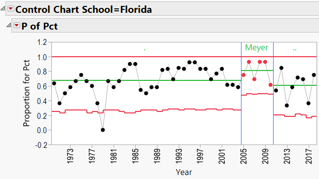

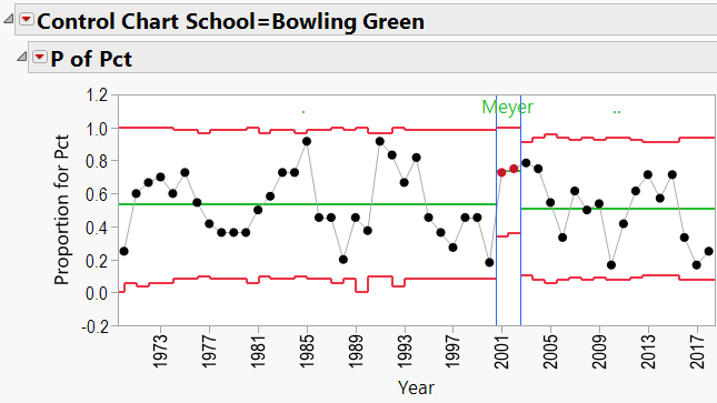

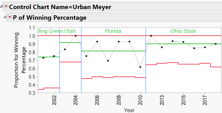

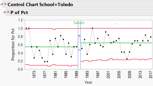

Appendix 3 contains all these charts. Since Urban Meyer has traveled to several different schools during his coaching career, let’s have a look at his results:
Figure 6: Urban Meyer’s Coaching History Across Various Schools.Figure 6: Urban Meyer’s Coaching History Across Various Schools.As we look through the charts in Figure 6, we see that each school’s winning percentage was consistently higher while Meyer was in town. So it appears that Meyer was good for the hiring school. Similar results are seen for other coaches in my list.
