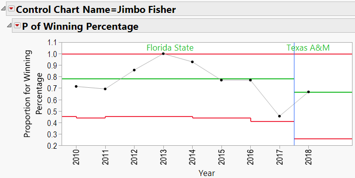

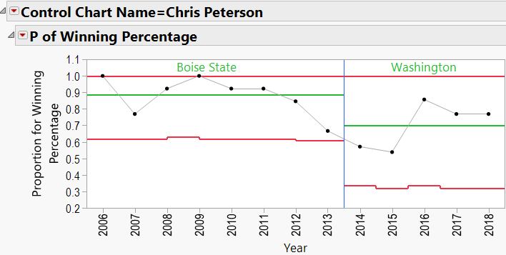

I also wanted to know if these coaches had consistent W/L records over time (even when changing schools), or whether (for example) they got better over time. For this, I turned to the Quality and Process tools in JMP.
As for Question 1 (above), we are dealing with percentages (i.e., binomial distributions). Therefore, rather than generating typical control charts for normally-distributed data, we turn to a “P-Chart.”
The P-Charts require a winning percentage for each coach by year. I used the original data table for this analysis, modified with columns for each year’s number of Wins and Losses, and added two additional columns:
  • One included a formula for winning percentage.
  • The second was a sum of W+L (i.e., total games coached each year).
I then used the Quality and Process/Control Chart/P platform to generate the charts.
A2:  Are the coaches’ records consistent over their individual careers?
Using the winning percentage as my response, Number of Games as my Sample Size, Year as my Sample Label, and Coach’s Name as my “By” variable, I generated P-Charts for each coach. Appendix B shows all the charts. Let’s have a look at Nick Saban’s chart:

Looking through the other charts (Appendix B) shows similar charts for other coaches, with an occasional “out-of-control” year, and variations from school to school.

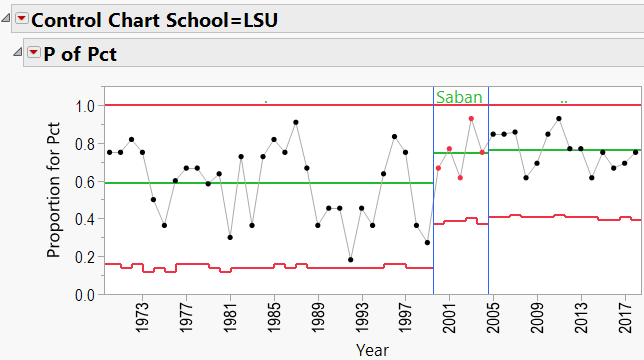

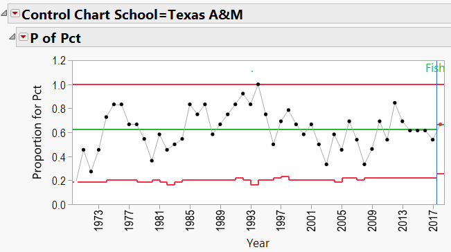

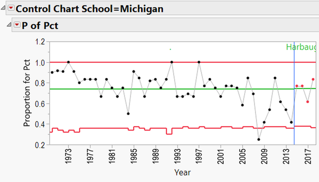

As mentioned in the discussion about coaching consistency, it appears that moving to Alabama was good for Nick Saban’s record. Can the same be said for the school’s good fortunes? In other words, can we say that Alabama benefited from hiring Nick Saban?
This is again a P-Chart question, but we need to flip the axes. First, I downloaded all of the W/L records for all schools coached by any of the 10 coaches in this study. I went back as far as 1970. This resulted in a data table containing columns of School Name, Year, Coach Name, Games Played, and Winning Percentage. I added a column called “Top Coach?” that  contained:
  • A dot (“.”) for any school/year that was not coached by one of my 10 coaches.
  • The coach’s name if the coach during that school/year was one of my 10 coaches.
I also used “Color by Row State” to color all rows red where the school/year was coached by one of my 10 coaches. This helped to highlight those particular years in the control charts.

The P-Charts were set up using:
  • Process = winning percentage
  • Sample Label = year
  • Phase = coach’s name
  • By = school name
  • Sample Size = total games per year

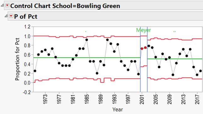

Appendix 3 contains all these charts. Since Urban Meyer has traveled to several different schools during his coaching career, let’s have a look at his results:
Figure 6: Urban Meyer’s Coaching History Across Various Schools.Figure 6: Urban Meyer’s Coaching History Across Various Schools.As we look through the charts in Figure 6, we see that each school’s winning percentage was consistently higher while Meyer was in town. So it appears that Meyer was good for the hiring school. Similar results are seen for other coaches in my list.

    • Again, JMP’s Control Charts show that wherever these coaches are employed, the school’s good fortunes seem to improve.
