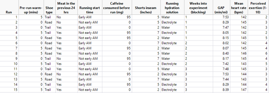

Results: The Take-Home Message

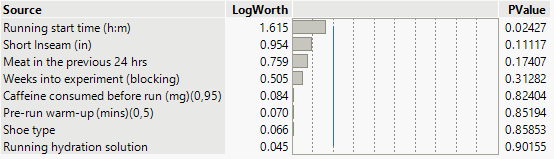

Timing matters! When modeling results based strictly on the controlled DOE factors, the most significant factors are ‘Running start time’ (earlier is better), followed by ‘Short inseam’ (shorter is better). If you learn nothing else from me today, it is that you should run early in the morning wearing short shorts. You can thank me later.
DOE factors (inputs) and responses (outputs).DOE factors (inputs) and responses (outputs).
 Standard Least Squares effects table of DOE factorsStandard Least Squares effects table of DOE factors

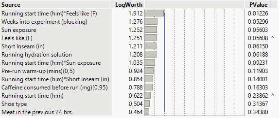

Standard Least Squares effects table considering DOE factors, additional uncontrolled factors, and secondary interactions. ^denotes effects with containing effects above them.Standard Least Squares effects table considering DOE factors, additional uncontrolled factors, and secondary interactions. ^denotes effects with containing effects above them.
Looking at the secondary effects of Feels like temp, Sun exposure, and Short length with Run start time, we see a more complete picture. Now seven variables have a PValue >0.1. So fascinating!
However, when examining the Prediction Profiler, I see that the model is predicting that more sun equates to faster running. Intuitively, I know this is false. Why could this be? I’m blaming a lack of data — there were only two runs in this study with sun exposure >50%.
Let’s re-run the model dropping sun exposure and, at the same time, drop variables with a PValue>0.3, to reduce noise.

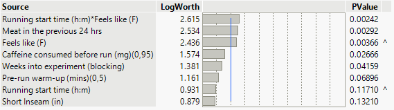

Standard Least Squares effects table of relevant factors.Standard Least Squares effects table of relevant factors.
This is quite amazing. This tells me running is as much about the environmental factors outside the body as within. Timing, weather, and consumption (meat and coffee) exert the most leverage on the responses.

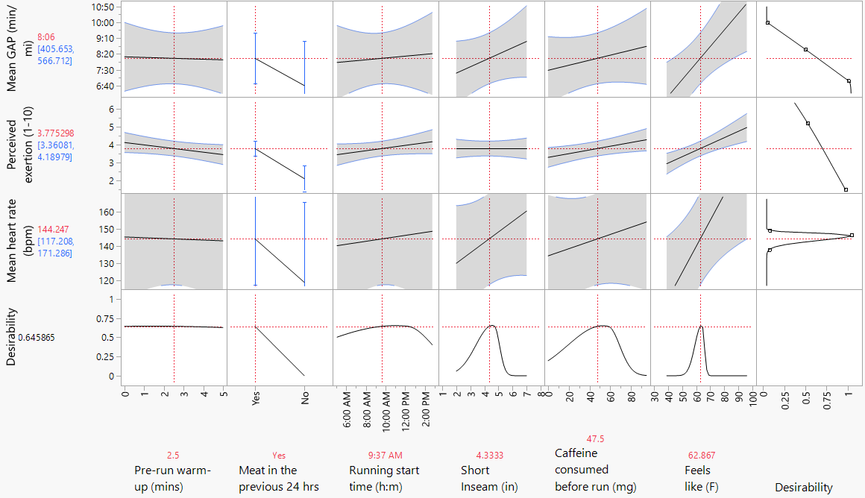

How well does this model predict responses? OK…
Prediction profiler of results.Prediction profiler of results.
Uncertainty is substantial, and apparently if I become a vegetarian, I could clock sub 6-minute miles. It seems to me more controlled runs are necessary, but this is a heckuva start and has pulled back the veil on a fairly nebulous process.

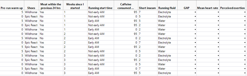

The best method I could come up with to "normalize" the runs relative to each other was to try to run them in the same manner. To accomplish this, I attempted to finish each run with a mean heart rate of 144 bpm. I went as far as to run faster downhill and slower uphill; in general, despite intrarun variations, I was able to get within 1-2 bpm of this goal despite variations in routes and run distance.
 DOE factors table.DOE factors table.
Note: Due to weather and my own stupidity, respectively, runs 10 and 13 became ‘Yes’ to ‘Meat in the previous 24 hrs.’
