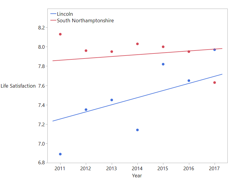

I fit something called a random coefficients mixed model to the complete data. The model tells us that the average Life Satisfaction for the UK was 7.47 in 2011/12 and has increased at an average rate of 0.050 each year (with 95% confidence intervals of +/- 0.02 and +/- 0.004, respectively). It can also tell us about the trends for each region.
Here, you can see the data (points) and the model fit (lines) for South Northamptonshire[2] and Lincoln.
Data and model for Life Satisfaction (2011-2017) for Lincoln and South NorthamptonshireData and model for Life Satisfaction (2011-2017) for Lincoln and South Northamptonshire
The starting Life Satisfaction in 2011/12, or the “intercept,” varies between regions. The rate of increase, or the “slope,” also varies between regions. Some, like South Northamptonshire, started higher and have improved little (high intercept, low slope).[3] Others, like Lincoln, started lower and have improved more (low intercept, high slope).

[3] You may have noticed that the model fit does not follow the apparent downward trend for South Northamptonshire. This is because it is using the data from all regions to give the most reliable estimates of slope and intercept for each region. It is less influenced by individual deviations from the overall trend. This is good because we know that the yearly estimates for each region are somewhat unreliable.
