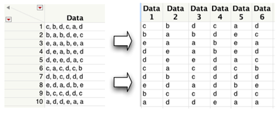

Text to Cols creates new columns from a column of delimited text. As shown above, the column “Data” has a comma-delimited string. Text to Cols creates the six new columns to the right.

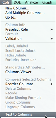

After installing the Text to Cols add-in, you’ll find a new menu at the bottom of the Cols menu.

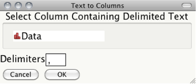

When you select this menu item, you’ll be prompted to choose a column of text and specify the delimiter.
Select your column and click OK.
New columns are added to the data table to contain the values from your column. Each new column has a formula using the Word() function to derive its value.
