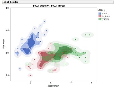

Now, when I output a graph, the dimensions are much larger. This makes it suitable to use in printed materials, posters and any other situation that necessitates a high-resolution image.

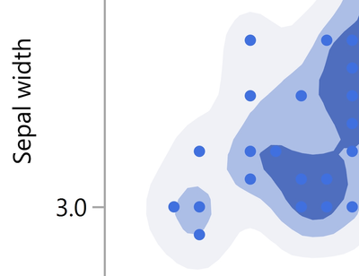

And here is the image at 100%, notice it is much larger it is than the default output resolution from JMP.
