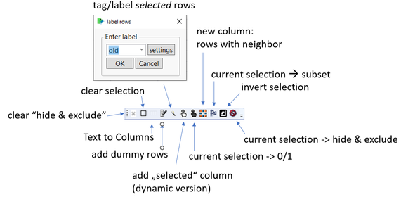

Overview:
Short description of the Shortcuts:
1. Clear Hide & Exclude. Reset the hide/excluded state of all rows.
2. Clear selection clears the row selection
3. Text To Columns ... (from Cols/Utilities) *)

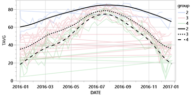

4. add dummy rows
    workaround for Graph-Builder-Combine-Smoother-and-Line
    select as many grouping columns as you want - JMP will add a dummy row (with missing value) for each combination
    in the plot, select Missing Value: no connection
5 - 7: Three shortcuts along the idea: Save the current selection as a column:
5. Label Selected Rows. Similar to Name Selection in Column ...
The differences:
- It uses a column with data type Multiple Responsenew information is appended, no pre-existing value is overwritten. This allows the user to collect information in an iterative way.
- predefined tags (which can be edited by the user via settings)
6. Add Selected Column (dynamic version). Generates a column with formula selected()to dynamically label selected/non-selected rows as 1/0. The column can be used in GraphBuilder plots as Overlay or Color to dynamically split the evaluation between the selected and non-selected subset (like it is explained in several webinars and Community posts).
7. Add Selected Column (static version). It just saves the current selection as 0/1.

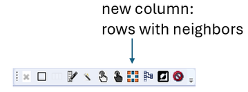

8. new column: rows with neighbor
adds a new column with a vector of all rows which are "neighbors" of the specific row
a) specify the coordinates
b) optional: specify the grouping, e.g. lot & wafer
c) which kind of neighbors?
9. open the current selection as a linked subset
extremely useful for on-the-fly data curation and exploratory data analysis
10. Invert. Invert the current row selection. "select all rows" (if no row is selected) *)
11. Current Selection -> Hide&Exclude. Mark the selected rows as hide&excluded *)
*) Thanks to a wonderful tip by @Jeff_Perkinson , the 3 Shortcut functions are now recorded by the advanced Log:

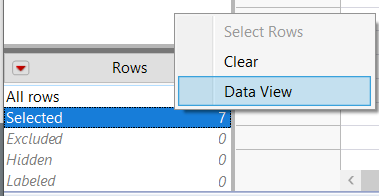

The Subset function alone will make this an amazing toolbar!  I use that one all the time.  I will probably use Invert Selection much more with this quick access.
Can I ask why just Exclude as an option and not "Hide and Exclude"?  I tend to use the latter, as I don't want the "bad" points skewing graphs either.
hogi
Nice to hear, same for me. I got so used to it - couldn't work without.
Before the AddIn I used Selected/Data View.
Actually, just with a tiny time penalty - but a thousand times a year !

You could always have one button for just exclude and one for both?  The "clear" button would still clear both states.
Thanks for the tip on creating a view from the Selected line in the Row Summary.  I have never clicked on those before and didn't know there was any functionality from there!

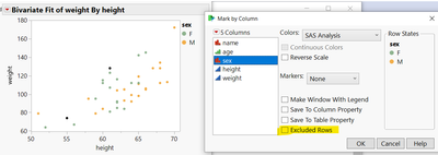

hogi
via
the color/marker setting is also applied to excluded rows?
Hm ...
hardner
@hogi , yeah, I don't know why you'd ever want to actually check that box vs. leave it unchecked so you get the effect that if excluded rows are not hidden they are distinguished. But at least with the default of unchecked you get an effect that could make sense of just excluding and not hiding...
hogi
Ah, got it now.
seems to be another 99 - 1% setting : )
Another 99 -1 % for me: Row States
I love to use Value Colors
hogi

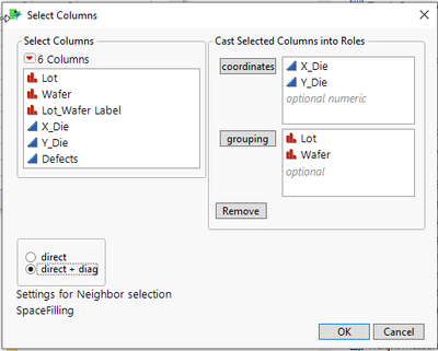

2 new features available:
    workaround till Graph Builder: Line - possibility to add breaks  is availabe:
    a) specify the coordinate system
