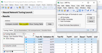

Hi @Marco2024
To analyze two or more variables, you will need to create a model for each and then load the prediction expressions in the Profiler:
  1. Build a NN model for your first output (Y) and save the prediction expression by clicking the "Save models" button. The "Profiler Formulas" option will save a single formula column to your data table.
  2. Repeat this for all the Y-variables you would like to compare.
  3. Launch the Profiler (Graph > Profiler) and load your prediction expressions.
This will provide a profiler for each of your Y variables stacked on top of each other to help you compare and co-optimize your system.
